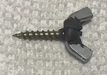

I'm in the process of replacing the air filters and suggest you wait a day or so. I have already come up with one change not previously mentioned:
Matching the thread of the original screw, I used JB Weld to put a wing nut on a hardware store, wood screw. This means no longer having to use the T20 while laying on your back reaching up about 4-6" into the dash.
I also have an approach that solves laying on your back to access the dash which I'll share this weekend.
