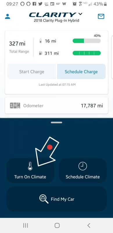

I wish there was a way the Honda Link app would allow me to turn on A/C from anywhere in the world via cellular link....
The remote fob won't work for me as I am about 1/4 mile from where I park and work.
I'm not sure if I'm following you, but if I understood you question, yes, there's an option to do it as you described. Just open the app and in the bottom panel you will find the option. It takes around one minute to complete the command and works fine.
