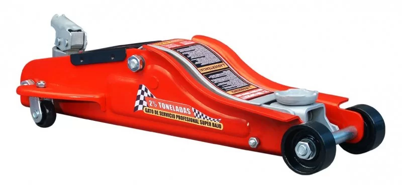

Any considerations when changing wheels for winters? If I t’jack 1 wheel at a time at the jack points indicated in the manual, where would I put the jack stand, etc...
I have a 2.5ton low profile jack that I use on my other cars. Will it be ok for the Clarity?

OP is proposing doing one wheel at a time? And not going under? If yes I’d just use the jack on a jack point and change the wheel. Then move to next corner and repeat.
Jack stands prevent car falling on head and killing you. It’s equally effective to not get crushed if you simply don’t go under the car...which I assume you’re not gonna do.
Sounds like you have a good jack that can easily and safely support the car. I say for this purpose just use your floor jack at the jack points, and skip the jack stands entirely.

Yes, I am swapping different sets of wheels not rotating. So doing it one by one should be ok? I can still put jack stand just in case I guess... just not sure where ...
On more thing, my jack has a round cup attachment - it’s this one:
and I don’t want to damage the undercarriage in any way (Lots of salt on the road = easy rust), so which rubber attachment should I buy?
Just to chime in, that front center jack point is WAY back. I was excited to learn about it from the tire rotation thread, but when it came time to use it, my jack actually couldn't get back that far and still lift. Just look at the diagram, it's slightly behind the front axle, which is a good distance from the front lip. I'd just use the side points. If you're worried about jacking up (ha ha see what I did there) the pinch welds, you can buy a hockey puck and just cut a trench down the middle of it to use as an adapter for your floor jack.
Yes the floor jack in the pic will work on the pinch welds. I do nothing to protect mine but i suppose if you’re worried about scratching the paint there you could just put anything on the round pad. Wood scrap, something plastic out of your recycle bin, an old towel..

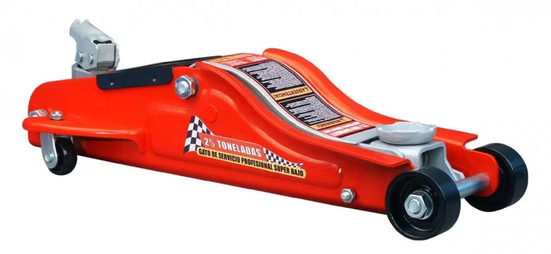

I bought these el-cheapo from China at $2.89 with free shipping and no tax. Just have to wait awhile to get them.

A bunch of Amazon options (scroll down a bit) and no waiting for the slow boat from China.
https://smile.amazon.com/Universal-...k+Disk+Rubber+Stand+Pad&qid=1571363033&sr=8-1
True, buts it’s 3x the price.

Too late for the bicycle delivery from China, will be swapping shoes in the next couple of weeks. planing to go the puck route how wide should I cut the trench?
