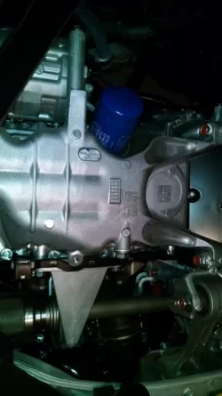

Oil change #2 complete. Sample captured to mail off. Some notes:
1) Although I didn't use it today, this maintenance mode might work to warm up the battery for U.S. Clarities that won't start otherwise at negative Fahrenheit temps? Did anyone ever find an official source of these instructions to get the vehicle to start the engine in maintenance mode?
2) The Clarity sits lower to the ground than my previous vehicles. I had to drive it up on to 2x6 wood to get it high enough to roll my shop jack under. Lifted against the aluminum frame just aft of the oil pan.

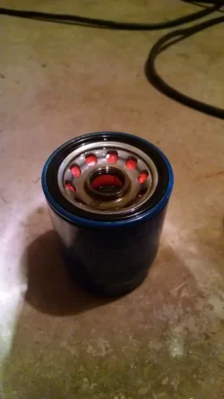

3) The dealer performed the first oil change. I noticed the dealer-installed filter had the rubber seal down inside where as the A01 that I bought did not (pics attached). Dealer-installed didn't have p/n on it but said "Made in USA" whereas the A01 says Filtech and "Assembled in USA".

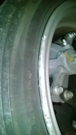

5) I found some damage to the inside of one of my wheels that could not have happened while driving. There are no scuffs on the tire but gouges on the inside lip of the wheel and some chunks of metal between the wheel and tire (that don't even look like they came from this wheel). I've added this to the list when I carry it in for the service bulletins.

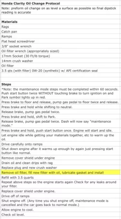

I ended up deciding to pre-fill the filter prior to installation. And it came out to 3.5 quarts total.
Thanks MrFixit,
Good to know on the warm up.
Your experience agrees with mine (and the manual)... 3.5 quarts total whether you pre-fill the filter with some of it or just dump it all in and let the engine fill the filter, it works out the same.
Final Draft..thx for the input.
