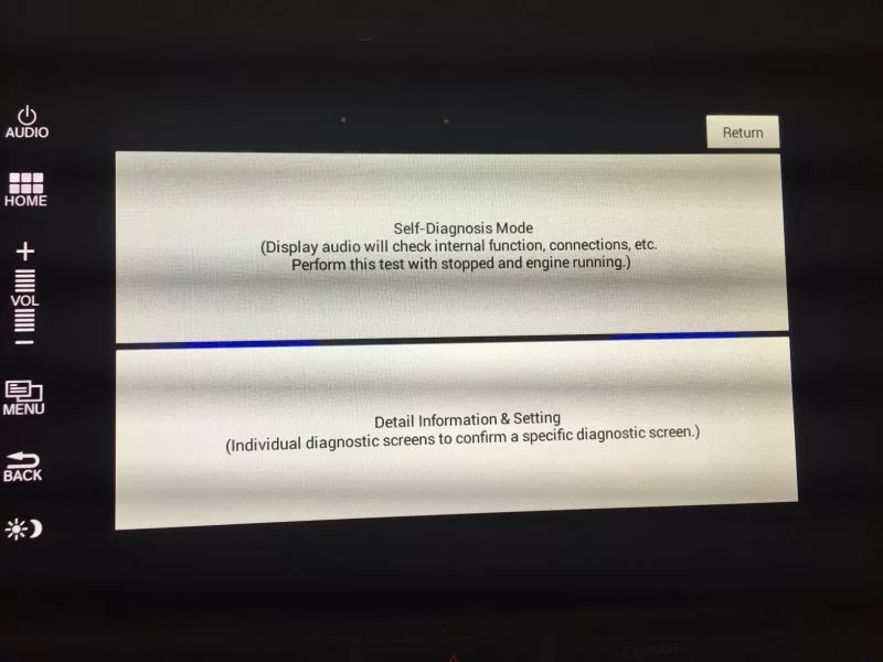

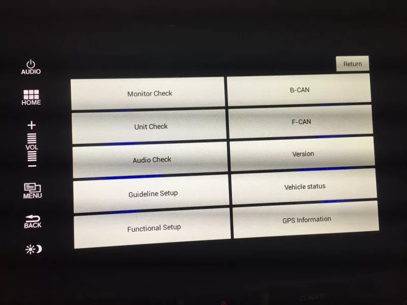

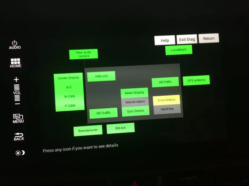

I found that if you press and hold the Power + Menu + Night/Brightness buttons simultaneously, it will bring up the hidden diagnostics and settings menu. I didn't play around with it much yet. Photos attached.

Awesome! How the heck did you find that?
Just tried it and navigated around a bit. Version brings up a whole lot of versions, so plan on taking a picture or writing it all down.
For others who want to try it, by "Power," TheDom means the Audio button on the upper left of the center display.
Correct. The "Audio" button has a graphic that combines a zero and a one. Engineers sometimes use the binary zero and one to mean "on" (one) and "off" (zero) so I intuitively said "power." I found it because I knew that the other Honda infotainments had similar hidden menus, so I just tried every combination until I found it. :cool:
Just wanted to make sure folks didn't think you meant the Power button that turns on the car.
Thanks for posting the tip. It's a great find!

This hidden menu is cool. So, I was exploring the different parts and clicked on GPS, even though I don't have the Touring with a navigation system. It looks like even the base level has the GPS hardware. The hidden menu shows the GPS system picking up satellites and figuring out the current position. I guess this isn't surprising, but it does beg the question why Honda doesn't offer a software upgrade for the navigation system. I may not be willing to pay thousands of dollars for the full Touring, but I may be willing to pay many hundreds of dollars for the navigation system.
Yes, base has GPS as part of the cellular connection the car has for HondaLink. Agree that nav should be a software option. Maybe the bean counters didn't figure it out?
