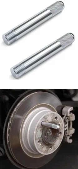

First time I have worked with lug bolts instead of studs & nuts. A little harder getting in place while getting the first one started.
These wheel-hanging pins make changing MINI wheels much easier.
