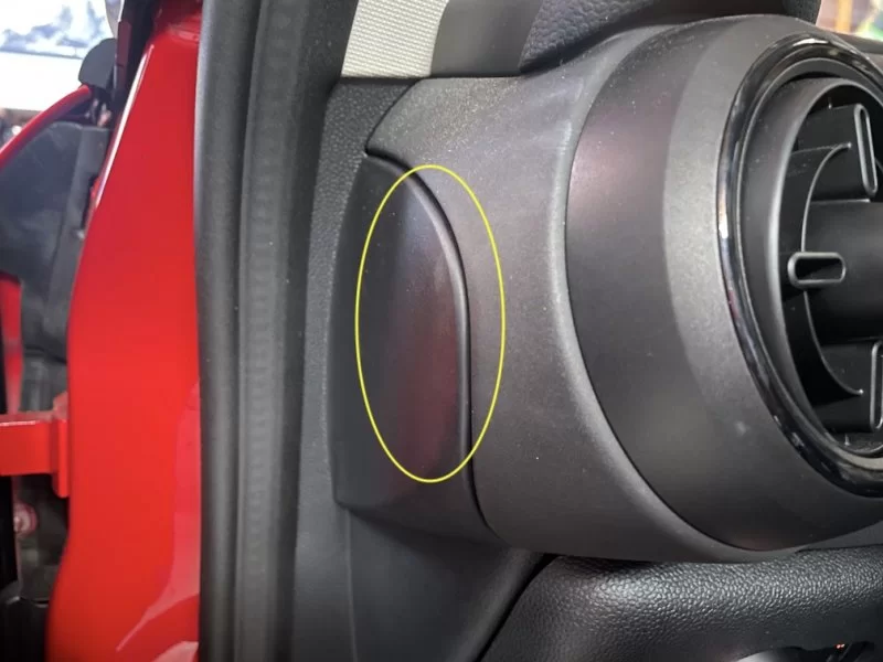

I have a rattle coming from the same area. What makes it stop is reaching to the left of the vent and pressing with my fingertips on the area shown in the picture below. I don't know if it's the same cause as your rattle, but it certainly is annoying.
Thank you! I will test this and report back.
