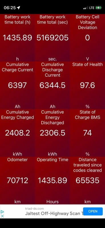

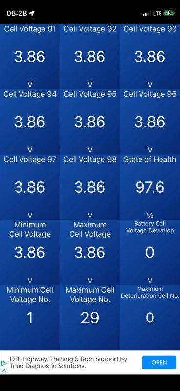

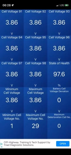

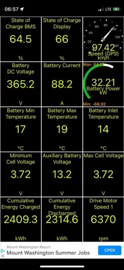

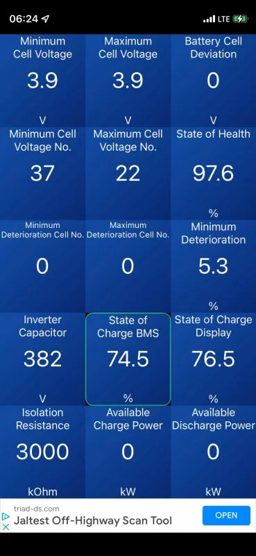

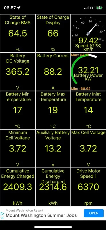

Well one things for sure, there is a more than enough data to figure out how your battery, and the rest of the car, is doing! Tried out a car
Scanner app on the drive to work today.[emoji15]IMG_6331.webpIMG_6333.webpIMG_6339.webpIMG_6345.webp
