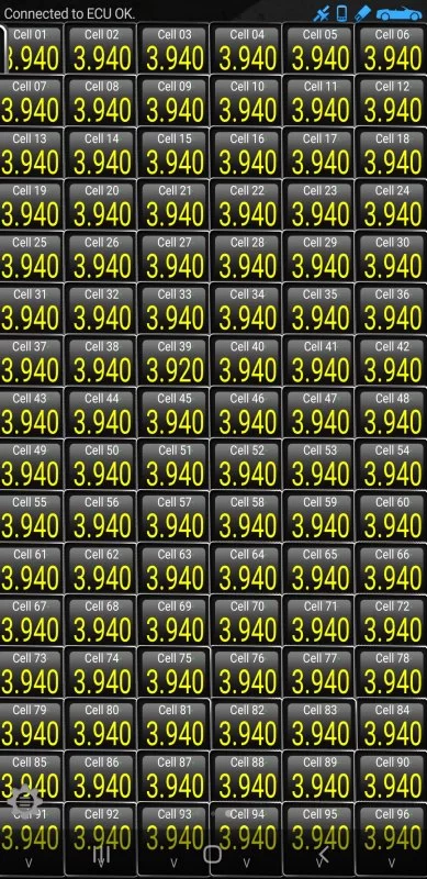

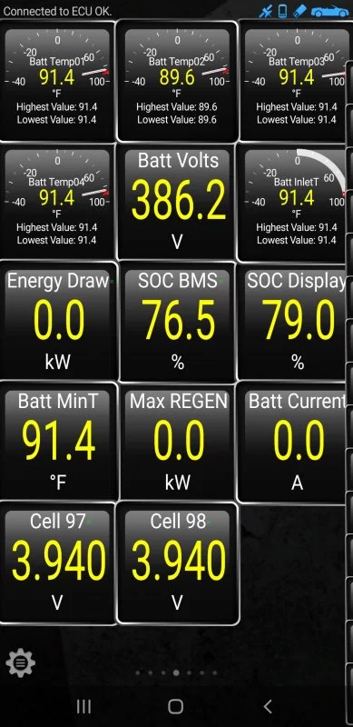

I hope that you are right.. At my driving, 15 years means over 500k miles..
My cell balances look beautiful as of right now.. Cell 39 is 0.02 off.. other than that, everything looks beautiful..
