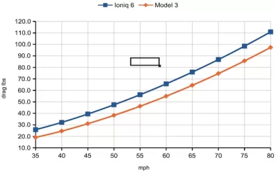

I've posted a request for a Monroney sticker from an Ioniq 6 but nothing, yet. I also checked Fueleconomy.gov and still no Ioniq 6. However, I did find the EPA test car data for the Ioniq6.
It turns out that the rear wheel Ioniq 6 and Tesla Model 3 are listed with the same test weight, 4,250 lbs (1,928 kg.) Then I graphed the drag using their roll down coefficients and lost interest:
  • The drag power curve will the proportional to the drag force curves
  • The Ioniq 6 drive train would have be shockingly more efficient than the Model 3
I have lost any curiosity about the Ioniq 6. Sheet metal art does not pay the electric charging bill.
One good thing is now I can easily calculate the drag force of all electric cars at 35 mph and 70 mph. I have been frustrated at early car reviews that don't give us an efficiency curve for reviewed cars. Problem solved.
