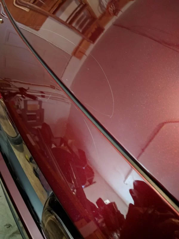

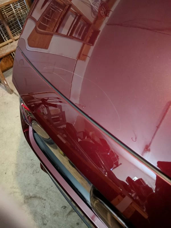

My grandson took a rock to the front of our Clarity. I feel a ridge on the line when I run my fingernail over it. Any suggestions? I'm figuring on asking my repair shop for recommendations for body shops and see if I need to get one that does Teslas. I don't know how much a body shop will have to do to fix it.
You might try a polishing wax or micro rubbing compound. Hard to tell how deep they are from the photo.
1 Meguiar's G17216 Ultimate Compound.

I use this for most of my minor paint blemishes: https://www.aircraftspruce.com/catalog/cspages/flyerspeedwax.php
and Magic clay.
I am sure there are some body paint guys that will have more tricks of the trade. There are micromesh products that work wonders but are expensive.

Hopefully, @craze1cars will chime in since he has extensive experience in insurance repairs. I’m going to guess that he will say any competent body shop can fix this using matching paint for the whole panel (looks like hood and that if you don’t have a lot of fading/oxidation on the surrounding panels, you won’t be able to tell the difference. You don’t necessarily have to go to a Tesla shop IMHO.
If it’s just in the clear coat, you may be able to effect a good enough DIY repair with Cash’s helpful post.

I've had pretty good luck with Maguiar's Scratch X 2.0, patience (multiple applications), and elbow grease. If you can remove it with the scratch remover, a good followup coat of wax can help with any residual swirl marks.

Thanks. I watched their video on Youtube. Makes sense to try the reasonable low cost option first and see what I get.
3m is my preferred product family. Impossible to assess from photos. Depends how deep it is. If in clear only, then possible wet sand, compound, polish, and finishing compound is the proper 4 step process. 3m makes a “perfect it”
Kit that does it all for $200ish for the product, and you’ll have no experience doing it so high probability swirl marks and errors.
Or just take it to a shop and ask them to wetsand and buff for you for about the same price by someone who does it every day.
If it’s thru the clear and into the base you’ll need to refinish it. But I suspect it likely can be wet sanded and polished by someone who knows what they’re doing.
but really it all depends how picky you are and how deep it is. If my car I’d ignore and move on, but I don’t get too worked up about minor flaws.

FWIW - Took it to a body shop. They said it was scratched too deeply to rub out. Estimate is $700. It will be covered under our Safeco with $100 deductible. I checked on the paint baking and they only bake to 140. The manual says not to exceed 150, so should be good.
