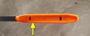

Well, this brings me back to the crappy dipstick discussed in the other thread. I changed my oil quite recently. I was very careful to fill with 3.5 quarts (new filter). After seeing your post, I went out this morning. I pulled the dipstick out and read it immediately - the oil level was here:
Next - I wiped it off, inserted it, took it out, and there was oil all over the entire orange portion and a little on the metal above. I repeated this and got the same result.
My thoughts - The crappy orange blob drags oil up into the dipstick tube and when you try to check it by wiping, and re-inserting, you can't get a clean reading because that oil gets all over the plastic (including above) and the reading is totally unclear. I believe you can only get a meaningful reading when the car sits for a good while, and you withdraw the dipstick and read it right away. Wiping and re-reading seems to just create a mess.
Regarding the temperature, I don't worry about that. I changed the oil cold (no warm-up first), and checked it cold (of course, you have to run it briefly to fill the filter), but sitting for a while then an immediate check without wiping... In my opinion, temperature has little or no effect. This is 0w20 oil which is plenty thin to flow perfectly fine even under cold conditions.
Generally, a dipstick (not this one) has 'calibrated' lines that help quantify how low you are (for instance, it will identify 1 quart between two lines). I am wondering it the two rectangular holes are supposed to represent, for instance, 1 quart. I have zero confidence in this thought however. but it would be nice to know.
It would be interesting to see if others experience this same dilemma - Go out to your car and 'read' the level by just withdrawing the dipstick. Then try to repeat the reading by wiping, inserting, then withdrawing again. I was just not able to do it.
Edit - One final thought. Yes, 'overfilling' can be a problem, BUT in my opinion, you would have to be way over the line before it was a problem. If the level is just over the orange blob, I'm sure that would be just fine. If you were a quart over, maybe that could become a problem. Given the above thoughts, my suspicion is that your dealer did not put 22 oz. of excess oil in. You may have been deceived by the orange blob !
Thanks for the reply. I'm a little under the level you show on your photo, but not much. I could probably put 6 oz back in and get to your level. That makes me suspect that they probably put 4 quarts in it instead of 3.5. I agree that the orange blob is a pain to read. I probably checked the oil at least 3 times each each time after removing some oil to make sure I could really see where the level was. It does make me feel more comfortable that you don't think overfilling by less than a quart is likely to cause any oil leaks (damage seals).
