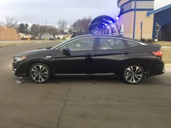

Well, I got the back two on today. Hopefully getting it cleaned up willl look at little nicer. Wish I could have afforded the 19's
Well I got the other two done today since I can inky got two in the trunk. Rides normal. I can’t imagine it make much of a different but we’ll see. They are on 16-17 accords.
That looks really nice. Much better IMO than the factory Clarity with those pseudo hubcaps.
These 18x8 rims come with +55 offset versus our stock +50. That means they sit 5mm more inwards. Is it noticeable?
To really but the inner rear kid the wheel is tight!!! You need 18”+. Imay still space them but I don’t see it making a difference. You barely notice.
The 19 inch wheels prove the maxim: less is more. Great simple design.
This looks very good. Too bad the wheels wouldn't be a factory option, not aero enough.
I can't see that they make any difference. I'm averaging the same as before and I'm all highway. That's where it would make a difference. City it would be zilch.
