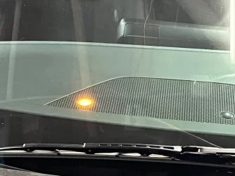

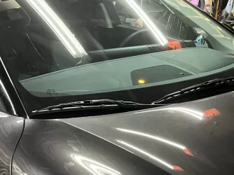

EV6 has an indicator light on the dash that illuminates when the 12v battery is being charged:
