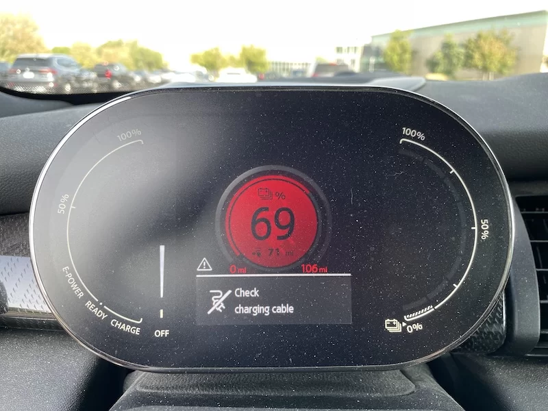

As I suspected in a previous post, my SE no longer works with DCFC chargers. I've now tried three different brands of DCFC charger: Electrify America, Dirt Road (ABB branded hardware), and ChargePoint. All of them give me a cable connect error. I had to travel more than 150 miles yesterday and my joy at finding numerous DCFC chargers on my route quickly turned to dismay when I confirmed the failure. I ended making the trip by spending slightly more than an hour at Level 2 EVSEs to get just enough charge to make it with 15% SoC to spare.

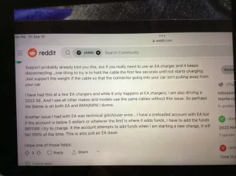

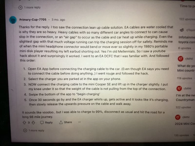

I don’t know if this help but I read this on Reddit.My car was never charged on DC yet my trips only up to 130 miles both way and I charge only in my garage IMG_1002.webp

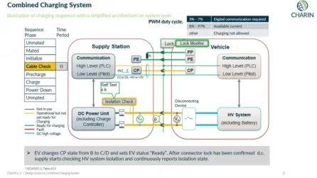

If it's getting stuck at cable check, then something is wrong the with locking mechanism (on the DCFC plug itself). J1772 charging should be fine because the locking mechanism is internal.
That's what it seems like, but since I've tried multiple DCFC chargers from multiple manufacturers it's got to be something on my SE.

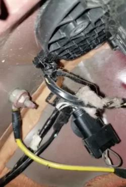

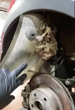

It turns out rodents had nested in the wheel well and chewed the wires to the charge port. Wires repaired and DCFC charging works now.
I had one wire chewed behind my front bumper. Cost $500 to replace. Was getting an error message, can't even remember what it was for
