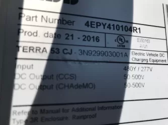

It looks like the same machine as 147203 Nanaimo (Terra 53CJ) but I know it was installed in phase 2 (BC Hydro) 2017? or later. So it appears that there is hope that firmware can repair the earlier installed models.

It worked for me for about fifteen minutes then crashed then I tried another six times and have up. Went shopping and came out and there was a BC Hydro worker there so I had a long talk with him and apparently it's a software problem that he hopes gets fixed within a week . It's an "ABB" problem the other manufactures have no problem .
This would great news if ABB still support this model with upgrades, let us keep our fingers crossed as the way it is now does't inspire a lot of confidence.
I just got a call from BC Hydro and ABB has just rolled out a new software update for there fast charger in Nanaimo so this charger will now work for our Hyundai Kona's

Thanks for that report, it definitely is the same ABB Terra 53cj model that has plagued the Island with various faults.
