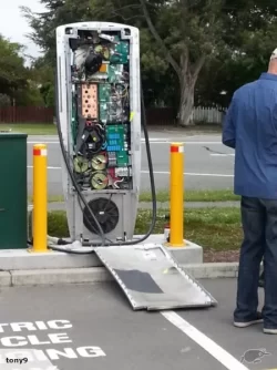

You might enjoy this ... a Tritium Veefil RT blew its cover off a week ago here while charging a tourist's EV. A few other units are getting revisions to avoid a repeat performance. No announcement on the cause yet.
Wow... that really is a monster SMPS, isn't it?? The Chargepoint 50k
units hereabouts seem to be Veefils.
_H*
The part hanging out appears to be the inductor (filter) for the negative DC wire, according to my inspection of close-up photos. That and many other components are liquid cooled with the radiator at the base. The (EMI) enclosure must be sealed well as a rapidly-outgassing component produced enough pressure to break all the fasteners and pop the cover. Most chargers in NZ are this same model.
