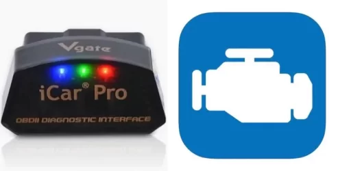

If you plug in an OBD dongle like a Vgate iCar Pro or just about any other brand and install the "Car Scanner" app on your phone, with the car in "Ready" mode you can find a single page with CCC, CDC, CEC and CED, etc values listed. If you post that screenshot I can probably determine if a BMS update was done.
These are super-useful for other things so a worthwhile purchase.

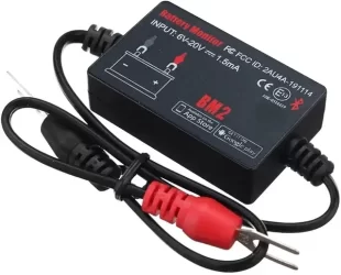

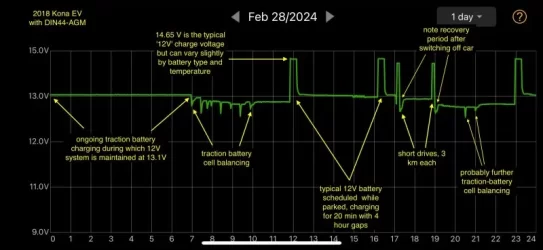

None of the other items regarding the 12V battery seem likely to have caused a problem but I'd highly recommend installing a BM2 monitor so you can verify the behaviour and learn how that all works.

Your 12V battery voltage seems slightly low. Be aware that when the traction battery is supporting the 12V system the system voltage sits at 13.1 to 14.7V. During driving it dithers between those two values depending on the 12V load
That "support" mentioned above is present (a) during traction-battery charging, (b) whenever the car is in Ready mode or Utility mode or (c) during automatic scheduled 12V charging sessions every 4 hours while parked. Unique to Utility mode is that the voltage is held constantly at about 14.5 as it's intended for 12V use, such as while camping. You can leave it in Utility mode for hours without any issue, or even use that to charge the 12V battery. While traction-battery charging the voltage is typically 14.7 for the first 30 minutes then 13.1 until the session finishes. Right after that it drops back to the native unsupported battery voltage but shows spikes every 30 min while cell balancing takes place for some hours.
It's very easy to run down the 12V battery as many discover to their detriment by leaving a door open while they sit in the car reading the owner's manual. Just joking ... no one ever reads the owner's manual!
