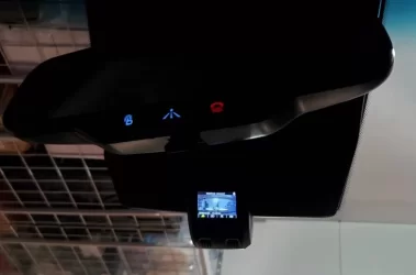

Anyone have any advice on a dashcam - and placement - that doesn't interfere too much with line of sight for both driver and passenger? The area around the rearview mirror is taken up with Kona's electronics - anyone come up with a creative solution to mounting? Just asking before the hopeful black Friday Amazon deals...
A119 front and back.

Picked up the A119v3 based on recs from here. Also FYI - if you run it through the fuse box you'll want to look for micro 2 fuse taps.
My question is - what are people using to mount to the plastic bit behind the rear view mirror. I tried the included 3m tape and it keeps falling off.
Make sure you wipe the plastic with some alcohol and heat up the 3m tape with hairdryer or even your car vent on high heat.
Also just to add to this thread if someone later is searching about dash cams - there is a small plastic cover that hides a chanel from the top of the windscreen to the arm of the rearview mirror. That cover can be removed (pretty easily) to hide the cabling for the dashcam if you mount it behind the rearview. Also - heating the 3M tape for a few seconds and wiping the contact surface with alcohol seems to have done the trick. Thanks all.

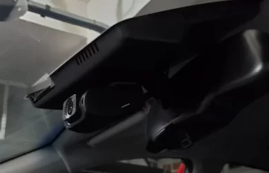

I mounted the dashcam to the right of the mirror. Ran the wire easily behind the window insulation and side door insulation an across beneath glove box. Then just plugged into a splitter itself plugged into the cigar lighter.

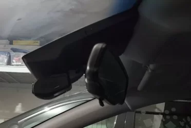

I finally installed my 4K Thinkware u1000 front and rear cameras with 256 Gig microSD card.
I also opted for the optional radar unit for the camera that senses approaching people and vehicle sized objects during parking surveillence, it basically facilitates energy efficient pre parking event surveillance recordings.
Power to the dual cameras for continuous and parking mode surveillance is supplied by a lithium cellink neo battery mounted in the glove box. The cellink neo battery recharges only while the vehicle is running via a hardwired micro piggyback adapter to the fuse panel. Basically with the aid of the radar unit and external battery it allows for several days of parking surveillance if required and it will never run down the car's 12 volt battery. Still have to tidy the wires, excuse the mess.
