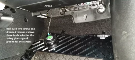

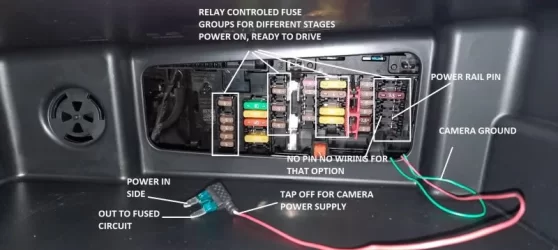

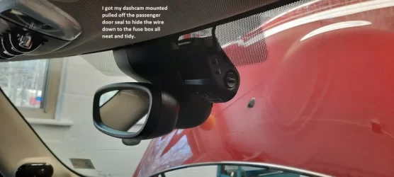

Installed in my Mini today Rexing V1 4k dashcam

Did you pry the trim panels off?
It was loose once the screws were removed a bit tight at the center consul but dropped down with out a fight I was going to take out the glove box but it was an easy install and did not need to get that involved.
