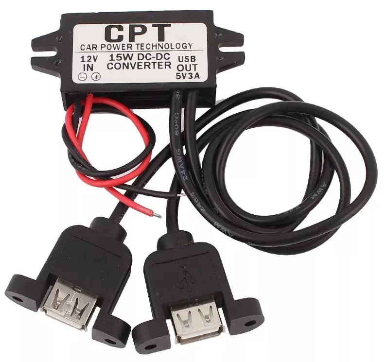

Bought one of these 12v to dual 5v USB adapters.

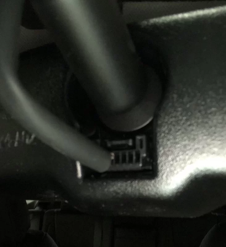

Borrowed this well documented method of tapping of power from the auto dimming mirror port.

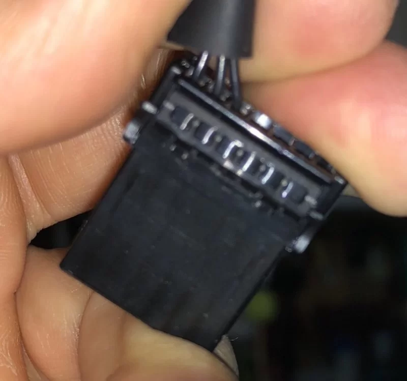

Checked the switched power and polarity Of the 3 black wires. The left is positive and the right is negative.

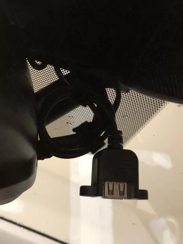

Tinned, soldered and shrink wrapped the leads. Tested 5v successfully. Mounted with double sided tape and tucked and Velcroed together.
Done!
Bought one of these 12v to dual 5v USB adapters.View attachment 1490

BTW, how did you physically attach the dashcam?

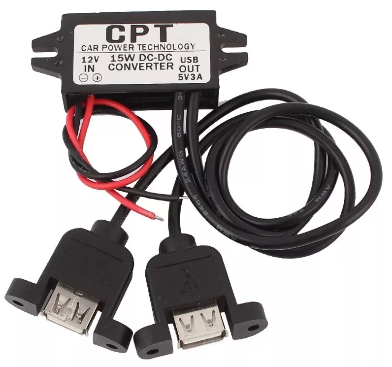

There is another THEORETICAL way that the 12v-5v converter might be causing problems. These are “buck converters” which can generate noise not only on the output, but on the input voltage. Sensitive circuits might then be affected by variations in their power supply. There are various solutions (putting an inductor in line with the converter, etc—google “input and output noise in buck converters explained” but looking for an alternate power source, as OP is doing, is probably the best solution.
