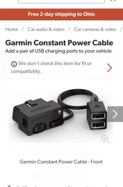

Thinking about getting this for a front dashcam, I like it because of the 10 min delay in switching off power. Anyone see any issue using this with the opd2 port? It’s only using the port for power

If you want the 10 minute delay, you can use any of fuses F73, F75-F78 which are all empty in the fusebox. You'll have a shorter trip to route the cable too, since it can go straight out the passenger side and up the window.
