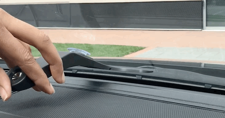

I was thinking of this.
It sort of wedges itself into the crevice between the window and dash, and it has a small suction cup to give it support.
I like it because I could check live video shots of my car while parked from remote. A bit pricey though.

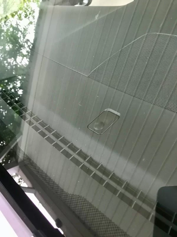

But ... what is this little raised button in the center of the dash for? Worried about blocking it.

That bump is a light sensor that the climate control uses in its algorithm along with interior/exterior temperature sensors and inside humidity sensor to control the AC and defrost and attempt to keep the windshield from frogging and run the CC efficiently. So you don’t want to block it entirely.
I don’t know what else the computer uses it for but I’m sure it’s not the headlights since we don’t have self dimming brights and it’s not the auto dimming rear view mirror which has its own light sensor (behind on dr side) and it’s own rear facing sensor (bottom).
BTW, that wedge mount is a great bit of kit if your dash cam doesn’t come with a mount. Thanks for sharing.

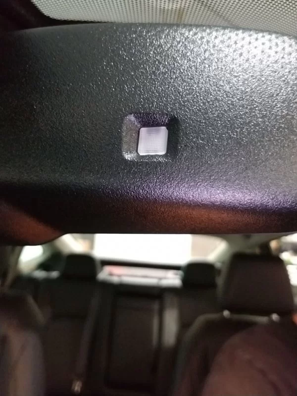

While we are on the subject, what is the small square on the back of the rear view mirror? What will happen if I put my dash cam in front of it, partially blocking it?

I think (no source) that is a daylight sensor for the rearview mirror auto dimming feature so it doesn’t dim in the daytime. I mounted my cam on windshield directly in front of it and it has about a 3” gap. I’m not noticing any problems.
