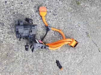

After 66 days, I have the car back. After replacing the OBC and still failing, this time without a code, the same continuity test (C14 pin 3 to 4) failed when it was OK before replacing the OBC. Both the wiring harness (which includes the charging connector) and OBC were then replaced, and now everything works.
This seems to have been a rather unusual failure as I haven't seen any mentions online of anyone having to replace this wiring assembly.
Thanks for getting back to us, always good to know what was replaced. Some have had to replace this assembly because the plug lock failed, at least in the Type 2 version.
Just in case anyone has forgotten to memorise the schematics, C14 is the J1772 charge port and pins 3 and 4 are the CP and PP signalling wires that go to the OBC, inside the upper orange cable here.
