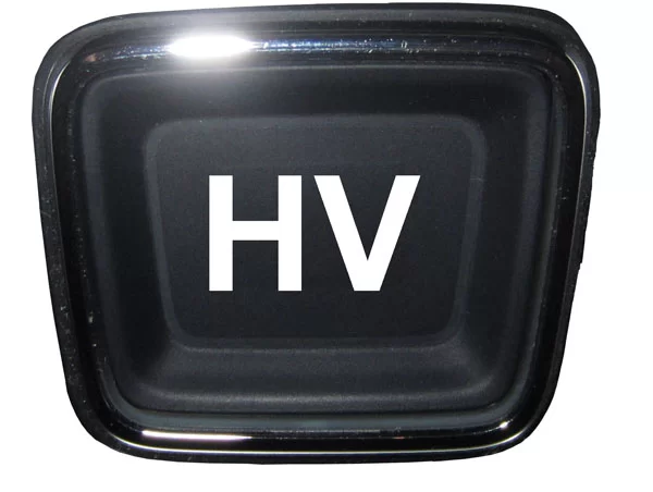

It's so discouraging to realize you've been using up battery power on EV for the last 30 miles because you forgot to press HV after stopping! So I never pass up an opportunity to re-post my economy HV-reminder. Print this image, cut out the paper HV button, place it over the D button and tape the top edge (then you can flip it up to press the D button underneath).
