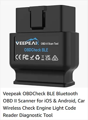

Thanks! What's a dongle exactly?
There are many available Bluetooth (and wired) dongles that plug into your car's OBDII diagnostic port under the dash. This is the one I bought on Amazon:

Insightman, are you using this with Bimmercode? I have had my SE for about a year now and keep telling myself that I need to check the real condition of my batteries.
I have used that dongle with Bimmercode, but only to enable the built-in AM radio. I'll know my battery is deteriorating when my range decreases.
