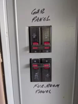

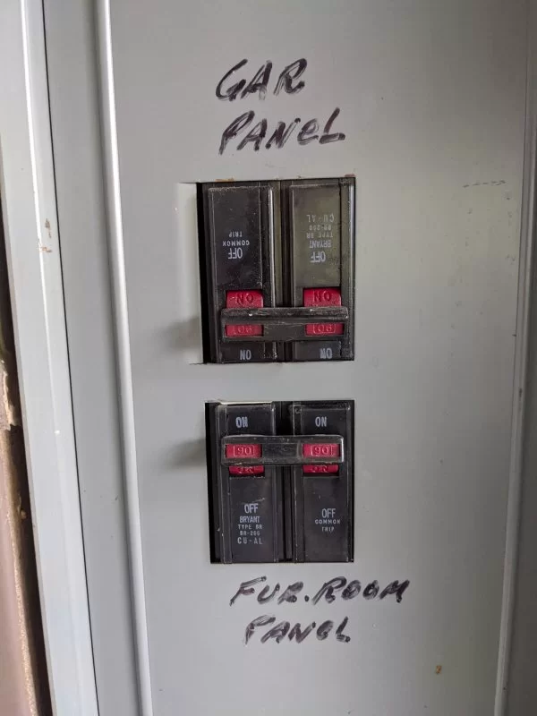

Here is a picture of the main panel. No open slots to run a new breaker/circuit and I assume creating a new panel would be $$$, too.
Is there a subpanel in the garage? Your new breaker would be installed there.
