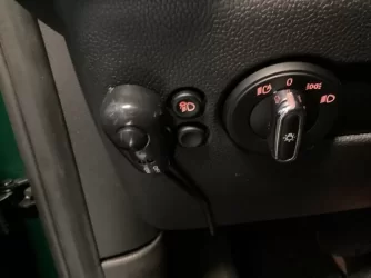

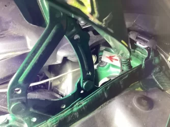

On right side under a hood is a rubber plug on fire wall which is easy access to interior of a car under a plastic panel under steering wheel .I use 3’ of 12 gauge copper wire gently pushing through that rubber plug and to my surprise I get a wire / snake inside a car to be able to install a switch for my yellow lights on my bull bar .This tread is just for information how to do it to my surprise was so easy which I never thought could be done without any drilling.White wire is my snake going through .
