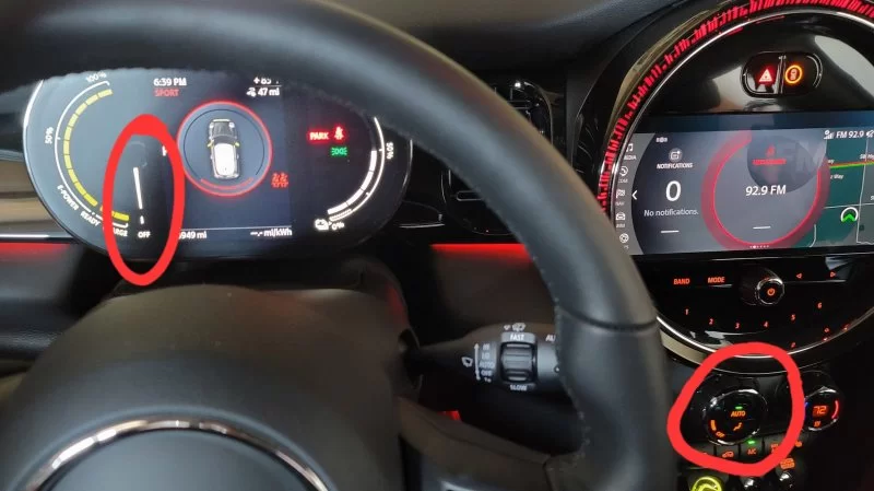

My car can't get into drive ready state while charging. The left needle stays down and doesn't get into ready while plugged in. Also notice that it's only fan blowing, not AC when I have car on during charging. The only way I can get AC during charging is with comfort climate.
Powered on with the needle at off (accessory mode equivalent) does run the AC, you just need to push the AC button!
