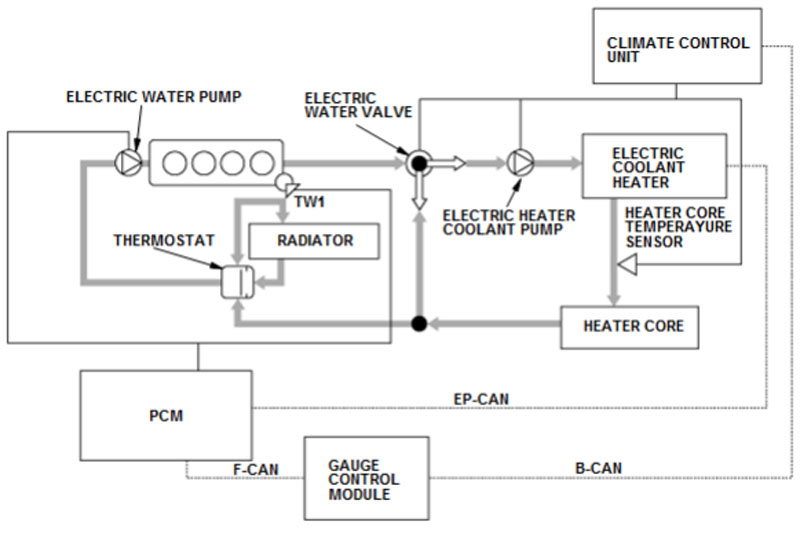

The PHEV doesn't get the BEV's heat pump system. Also, based on Honda's priorities for the most energy-efficient operation, I'm certain the electric heat shuts off when the engine is producing more than enough heat to warm the cabin.
Here's a heat-pump thread and a heating the car thread and here is the diagram from the PDF document that @AnthonyW provided us:
