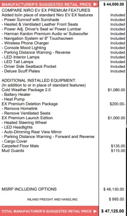

It looks like there are 2 versions being sold at least in WA. The Ex Premium Has a Launch Edition option which includes the Heated steering Wheel. See Window Sticker:
Wondering why Homelink and the Ventilated seats were removed.
There 10 EX models at Lee Johnson Kia in Kirkland, WA and the salesperson said they will not charge above MSRP.
There are two versions of the EX Premium being sold. One has the deleted ventilated seats and homelink. The other version has both. I got the version with both, even though they both are EX Premium. You just have to look around. Kia is not shipping as many with ventilated seats and homelink as they are with the delete package. Could be parts issue, no one seems to know. It certainly isn't because of pricing as it is only an extra $200.00.
