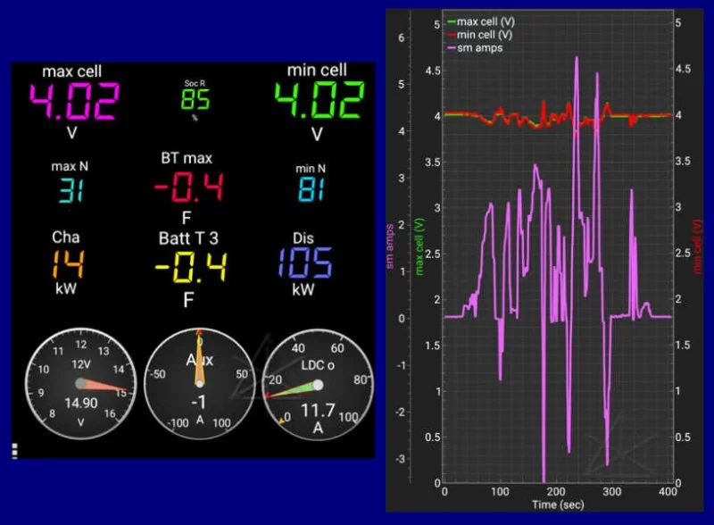

After the car cold-soaked in about -10F air last night, I went out this morning
to take a few stats and see if the car was actually okay. I had designs on
driving two hours to an event today, but figured that was off the table because
it would need at least one charging stop and at the "arctic blast" temps we're
having this weekend, that would just be battery abuse.
The OBD2 kinda confirmed that. The BMS returns two figures for "maximum
discharge power" and "maximum charge power", which I display as "Dis" and
"Cha" respectively. And lookie that: I couldn't charge at any more than 14
kilowatts, if that much, and even a bit of driving would probably not help that
much. So going anywhere significant today was off the table. [I didn't really
need to anyway, and tomorrow might be warmer]
But I did fire up and took a quick store run. The graph is the drive out of
the neighborhood. Under modest load, cell voltage sag was much more than I'd
seen in the past -- that red-n-green line barely wiggles under normal
circumstances. And my regen was severely limited, a little over 30 amps which
is about 10 kW, or one "blue bar" down on the car's display.
When I returned home, about two miles total, "Cha" had gone up to 15. Meh..
I explain the cold-weather difficulties to non-EV people as to envision trying
to pump gas when their fuel inlet pipe has shrunk to a 2mm capillary tube.
