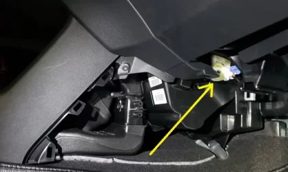

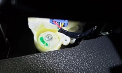

I eventually isolated where the sound was coming from by removing the kick panel in the passenger footwell, it comes off fairly easily just by pulling on it by hand and the clips will release. The arrow in the first photo is the location of the motor, all you can see are yellowish/white plastic parts you don't see the actual motor which I assume is behind the plastic parts. The second photo is a closeup of the part. The visible parts sort of rotate back and forth when it makes the sound so it was very definite that this was where the sound was coming from. If you remove the kick panel on your car you should be able to determine pretty easily if this is the part where the sound is coming from. Probably hard to see this in the photo, but there seems to be three plastic pieces sandwiched together, the center plastic piece is stationary, the piece in front and the piece in the rear rotate independently, although you only see a couple of tabs sticking out from those pieces.
If yours is the same thing you will definitely see movement within this part associated with the sound. Although if you only recently heard it, it's possible that yours is acting normally and you just happened to notice it for the first time. But if it goes on for minutes at a time then you may have the same issue.
I read about a similar problem with I think Accord or maybe Civic, the same part caused the problem, apparently inside the plastic part there is a sensor that determines the position of the rotating piece(s) which it then sends this info to the computer. The rotating parts ratchet a tiny amount at a time, thus the clicking sound. I am guessing the sensor tells the computer each time it has moved to the next position. Apparently too much grease inside the unit eventually dripped where it wasn't supposed to be, affecting the sensor when it was at certain positions, thus the constant back and forth (i.e. endless clicking) as the computer was not getting good information about the position of the rotating pieces. A couple of people fixed it themselves by removing the part, disassembling it and wiping the grease off the sensor. No way to know if that was the problem with mine, and the photos one person uploaded of the procedure, while seemingly easy to do, and the part seemed very similar, it was a slightly different part and removal would be slightly different, and certainly while under warranty I wasn't going to fool with it myself.

The part they replaced was 79170-TRT-A41 Motor Assy Air Mix (Passenger Side)(Passenger Air Mix Control Motor). The part was listed at $91.60, I don't know what labor was since it was done under warranty. There is another part number for the drivers side, 79160-TEX-Y61. I don't know where that one is located but I didn't hear any sounds coming from that side. Based on a diagram I saw I think the drivers side motor might be for the mix door that controls the percentage of air flowing into the cabin vents vs the windshield vents.

I had the same problem with our 2007 Odyssey, and also pn my daughter's same model and year, but both were on the Driver's side. It had that clicking sound, accompanied by a faint water gurgling sound, and caused the driver air temp to rachet up significantly. The unit uses a stepper motor that may pick up resistance or corrosion over time, and causes it to search. On the Odyssey, it was grease that spread out over time, and on to the contactors, resulting in continuity loss. I was able to temporarily fix them by cleaning off the grease - not sure of the cause on the Clarity, but I suspect a similar problem.

So as a test I simply unplugged the blue connector that you see in my photo in post #5. And voila! Blissful silence. And both heat and AC seem to work just fine, although I have been out of town quite a bit since then so my experience with the motor being unplugged is somewhat limited. I haven't checked with my scanner for fault codes, but I suspect there won't be. Now this does mean that the air mix door is stopped in a certain position, and I don't know what that position is. But I suspect that the door is not binary, i.e even when fully moved it probably doesn't totally block the heater core. We haven't had cold weather yet, but I expect it will provide plenty of heat even with the door fixed in whatever position it is. But if I suspected that the fixed position of the air mix door was causing a problem I can always plug it back in. And then I could unplug it again during the summer which is when the clicking noise seems to be even more active.
