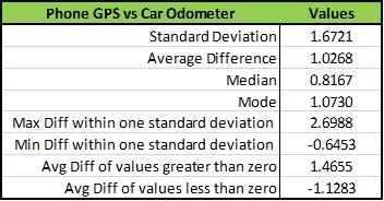

I took some Scantool readings of the car a few weeks ago. I was looking over the raw data and noticed that there are significant differences between the car data and the GPS on my phone. Now it is possible that there is something wrong with the GPS on my phone, but it is a new iPhone X. The Scantool reports data roughly every one second, but it appears to me that the polling interval of the car odometer is both greater than one second and must reach a certain change in speed before it updates. Summary below and raw data is attached. This website won't let me upload an excel file, so I had to convert it to text. If you download the file and open with Excel it opens in a nice, easily readable format.
