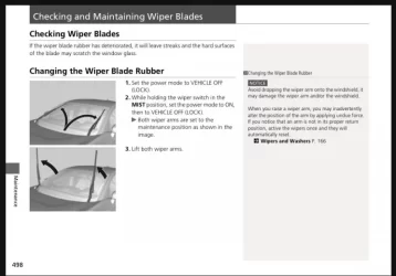

The mounting/pivot point on the OEM blade assembly is off center by .25” and the assemblies are side specific. Aftermarket assemblies, or incorrectly installed assemblies may not follow the same arc as the OEM assemblies.
Below are the instructions for putting the wiper arm in position for blade/assembly replacement. IMG_2824.webp

The page from the manual that was posted previously, included instructions in the sidebar for automatically resetting the wiper arm positions. Simply, “active (sic) the wipers ONCE (emphasis added) and they will automatically reset”. Perhaps just once is the trick?
