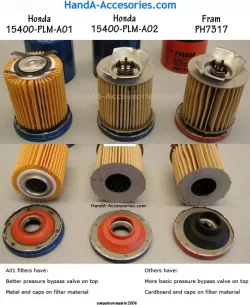

Here is the difference between the 2 Honda filters available (from hands.com):
“Honda interchanges part#15400-PLM-A01 with 15400-PLM-A02. They stock and ship both to their dealerships however the A01's are the in-demand part number for Honda filters. One major difference is the A01 filters have metal end caps inside whereas the A02 filters have cardboard.” So be sure you’re getting the A01 if using Honda filters.
Here is a comparison on the cut open filters side by side:
Filter mfgs have not yet added the Clarity to their list except for Fram that I can find. Here is the Fram # (PH7317) you can use to cross reference filters from whatever mfg you wish to use.

It seems like the 'A01' filters mentioned by @KentuckyKen at the start of this thread have not been produced for quite some time. Yes, you can find some on Amazon and eBay, but along with these, you can also find many reports of people ordering the 'A01' and being sent the 'A02' instead. There are also some references to suspected 'counterfeit' A01 filters.
I do not want to fall into the trap of obsessing over this - There are plenty of people who do. I would greatly prefer to use a filter that is currently in production, rather than scrounging around trying to find old stock of a discontinued filter. Years ago, I stocked up on some OEM filters, and they started to show some rust after sitting around in the garage too long. I wound up throwing them away.
My thought is to just go with the filter that Honda recommends (the 15400-PLM-A02). Yes, it seems 'inferior', but it is extremely likely that is what all the non-DIY'ers are getting with dealer oil changes. In addition, the Clarity hardly stresses an oil filter (for most people). I will have ~10K miles (only ~3K of which are from the ICE). As such, I'll be doing the obligatory annual oil / filter changes.

It seems like the 'A01' filters mentioned by @KentuckyKen at the start of this thread have now not been produced for quite some time (note date of KK's post was in early 2018 anyway). Yes, you can still find some on Amazon and eBay, but along with these, you can also find many reports of people ordering the 'A01' and being sent the 'A02' instead. There are also some references to suspected 'counterfeit' A01 filters.
Any other DIY'ers want to share their thoughts?
I also tried to look up the 'A01' filters at a couple of Honda part specialty houses, but received a "discontinued" part notice back. I am sure one can still find the 'A01' filters online somewhere, but it doesn't seem to be a mainstream Honda p/n any longer. (Please do note that @KentuckyKen's earlier post on this thread is dated "way back" in early April, 2018.)
That said, I have used the Fram XG7317 in my Hondas for quite some time, along with full synthetic oil. This is an upgraded Fram PH7317 mentioned by @KentuckyKen in his Apr 2018 post and does feature metal caps on both ends of the filter element and a filtration efficiency of 99%+. They are easy to purchase at Wally World ($8.97 each), Amazon or many auto parts stores, and Fram sometimes has $-off coupons on their web site that bring the price down another couple of bucks.
All of this said, it seems that everybody does have their own opinion on this subject, and the XG7317 may be unnecessary overkill and a waste of $ over the 'A02'. However, if one intends to keep a car for longer than a couple of years, on critical parts like oil filters I prefer to error in the excess direction (that is, I'd rather overspend $5 on a part like this than face far more expensive engine problems later).

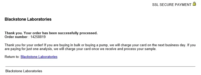

Seems what Honda actually monitors to what degree is mostly proprietary but the belief is that it is mostly raw odometer driven. For my second oil change for an estimated 3000 miles with the engine on (record gallons of gas purchased and multiply by 45mpg), I sent off a sample of the oil for analysis. The results showed the oil was fine and could have gone much longer before replacing.
