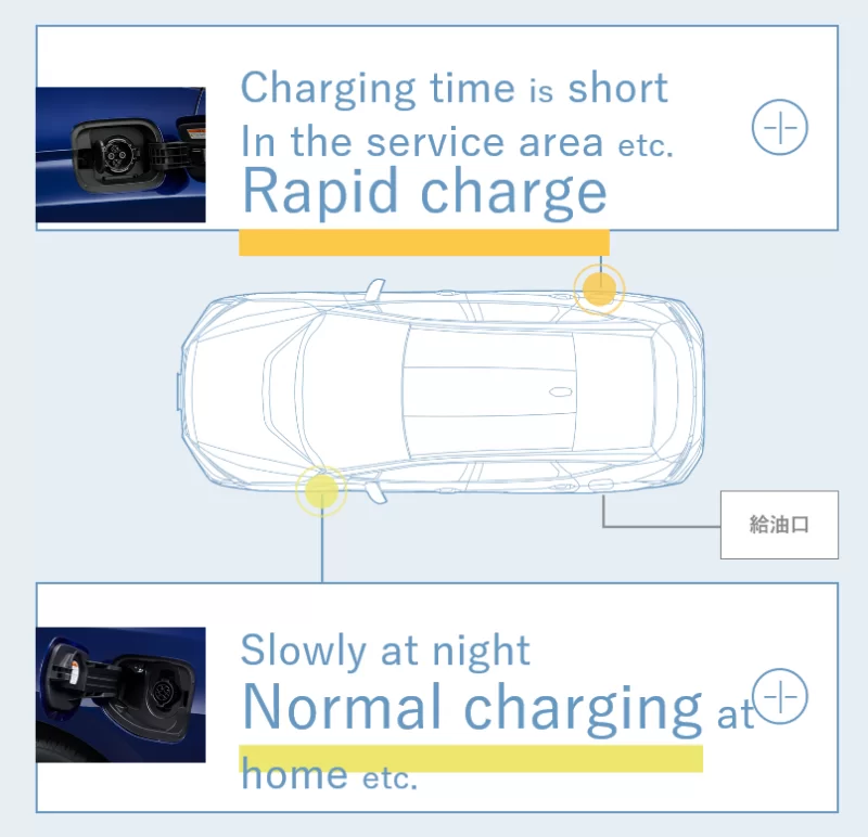

This is something I missed and is definitely interesting to me:
https://global.honda/newsroom/news/2018/4180719eng-clarity-phev.html
●PHEV features:
Equipped with the fast charging function, which makes it easier to charge on the go
  • In addition to a charge port for normal charging, the Clarity PHEV features a charge port for fast charging*3 and external power output, both as standard equipment. The fast charge based on CHAdeMO international standards provides an 80% charge in approximately 30 minutes*9. Clarity PHEV features the “Comfort Charge” function, which enables the use of air-conditioning units, audio system, seat heater and additional equipment during fast charging, which enables occupant(s) to stay comfortably inside the vehicle while the Power mode is turned on during fast charging.
  • *9Charging time to recover 80% charge from the point where estimated EV drive range is zero. Charging time and chargeable capacity vary depending on the specifications of the fast charger, the environmental temperature of the surrounding area and remaining battery charge.
Also: In addition to a charge port for normal charging, the Clarity PHEV features a charge port for fast charging*3 and external power output, both as standard equipment. By connecting to a compatible external output device, the Clarity PHEV can supply electricity to external devices*4.
*3 Compatible with CHAdeMO, the international standards for DC charging for electric vehicles, promoted by CHAdeMO Association.
*4Maximum power supply of 3kW
