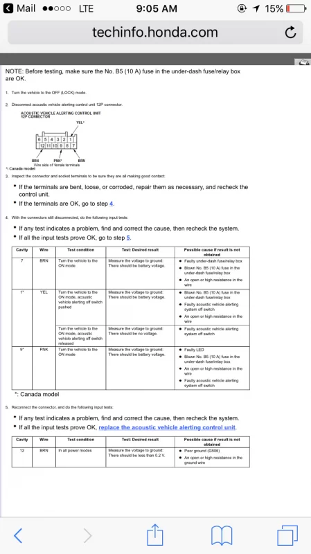

Looks like the AVAS control unit has a 12p connector. Under the dash. Just trying to locate it. I think finding this could solve the problem. .......

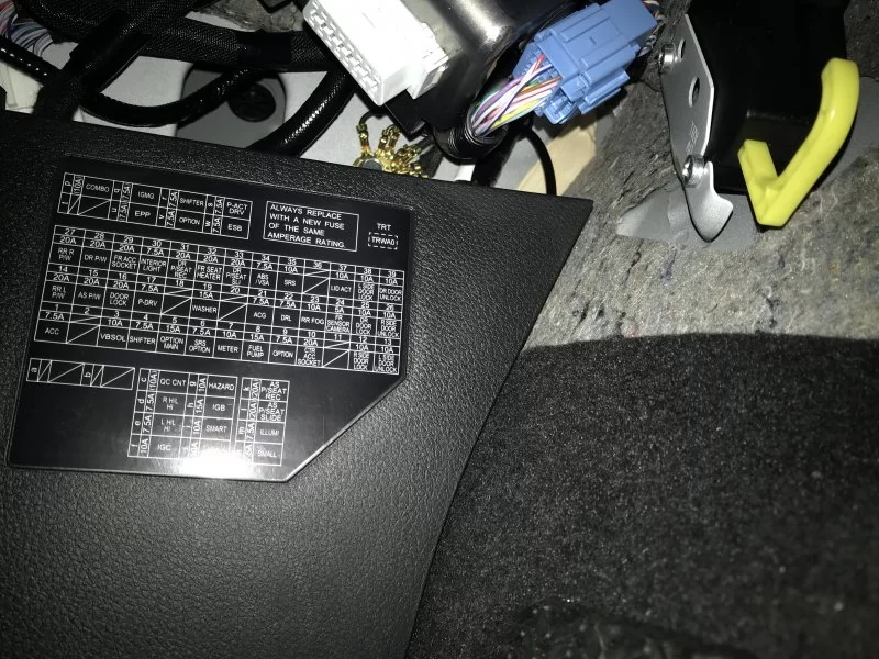

Lucien, thanks for the great info. The doc you posted says to make sure the B5 fuse is OK. So if that fuse doesn’t protect anything other than the AVAS, then that’s the one we’re looking for. Only trouble is that I can’t match B5 to the fuse diagram on the kick panel. Any ideas?
