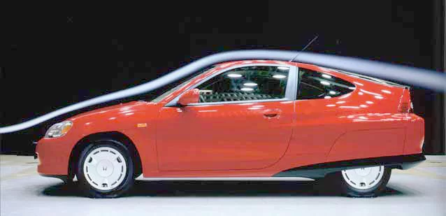

Still, I wish Honda hadn't discontinued revealing the coefficient of drag on their fuel-efficient cars. It would be a small way to reward the anonymous engineers who work so hard to minimize this number. Here's a photo Honda released nearly 20 years ago.
