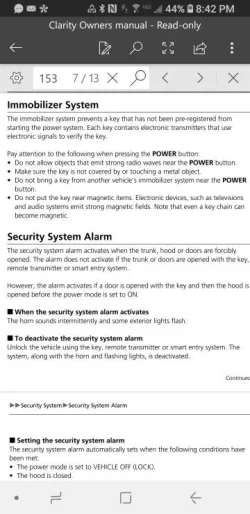

TNRT, could it be that you had another vehicle's key fob close to the power on button or something magnetized near the power on button that would activate the immobilizer system?
