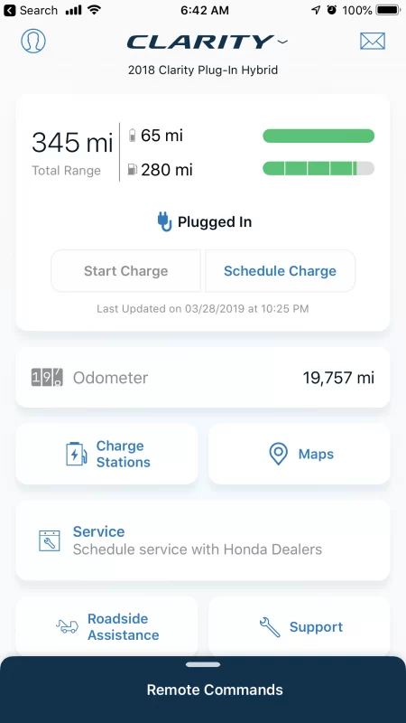

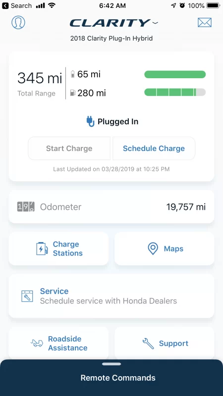

dpt
I've had an ongoing problem with my center gauge charging screen. For the past 6 months the car shows that it is not fully charged although the app shows it's charged at 100%. In the past I was consistently getting over 50 miles per charge and now I'm only getting 44 or 45 on average despite having the same driving style. I've taken my car to the dealership multiple times, they've updated all the service bulletin work and hsvectried to fix the charging problems three times now. Has anyone else had the same problem? Does anybody know a solution?
I've had an ongoing problem with my center gauge charging screen. For the past 6 months the car shows that it is not fully charged although the app shows it's charged at 100%. In the past I was consistently getting over 50 miles per charge and now I'm only getting 44 or 45 on average despite having the same driving style. I've taken my car to the dealership multiple times, they've updated all the service bulletin work and hsvectried to fix the charging problems three times now. Has anyone else had the same problem? Does anybody know a solution?View attachment 4199
There have been some threads on this in the past. The bar chart in the center console is range rather then charging status using (and guessing on this) 50 miles as the maximum range. It’s winter so your range is lower. The bars should go to the top with warmer weather. Not sure where you live, but all EVs experience a range drop in the winter. I went from low 50s to mid 30s - so I’d love to get back to your range!

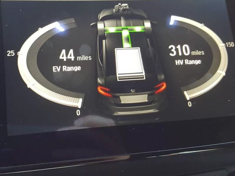

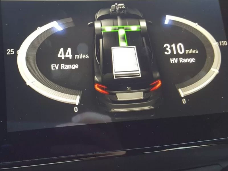

Looking at the picture of the energy info screen from the center Navigation Screen, it shows your traction battery is fully charged since you have all bars showing right up to the top. (Center bar graph)
The curved graph to the right is a an estimated EV range indicator based off past driving efficiency. It will decrease with cold related effects to the battery and with driving styles, speed, and road conditions (to name a few). It will increase with warmer temps and more efficient driving styles (slow easy accelerations, no jackrabbit starts/stops) and road conditions (less hills and head winds and snow and rain). Use of cabin heat and defroster will also significantly reduce your EV range.
So it appears your car’s center display is indeed showing a full charge. The EV range estimate to the right will fluctuate with a full charge based on past conditions. For example, from Spring to Fall I was getting 55 to 64 miles EV range estimate (about 4-5 miles less actual) and the worse in the winter was 46 miles (using only preconditioning and seat heater).
Enjoy your Clarity!
Didn't you mean the curved graph on the left? It appears to me that the curved graph on the right is the HV range.
Tim
Looks to me like everything is operating normally and you’re simply seeing some small seasonal variation. @KentuckyKen has the right explanation (with the small correction by @Tim66 ). Your dealer should have known this, but oh well.
