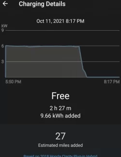

The first charging issue I ran into was at and EV-Go charger right next to my gym, I hooked up, went into the gym for around 2 hours and noticed that the charging light was off so I assumed the car finished charging. Nope, it only charged up to 3/4 full and even though I was in the gym for over 120 mins, the EV-go App says it only charged for a total of 108 mins. Since I was having issues connecting to the Honda Link app, I had no way of knowing the car stopped charging. I had no time to figure out the issue since I had dinner reservations after so I just noted the issue and moved on.

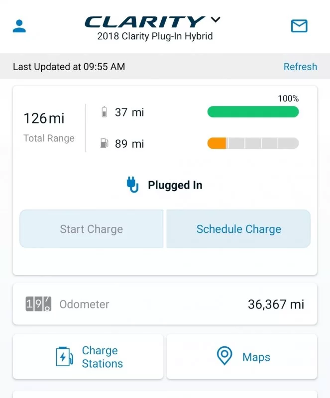

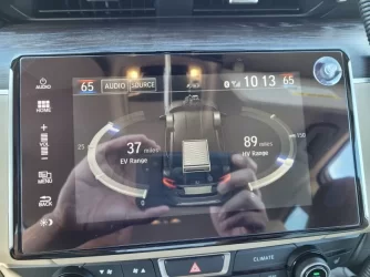

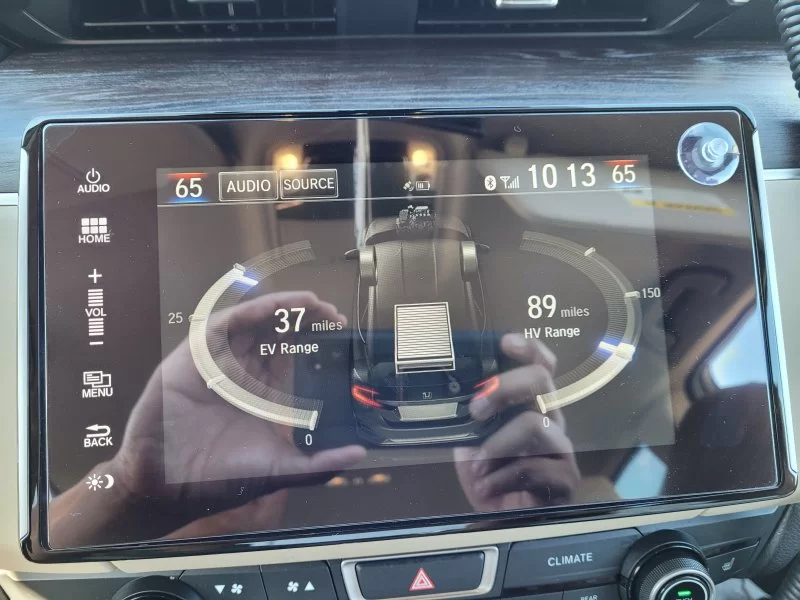

Yesterday at another gym, there are free level 2 chargers by the restaurants next to my gym and I snagged one up, I arrived w/ around 7 miles of range left. Plugged it in, went into the gym for my normal 120 mins + session, was tracking the charging the entire time through the Hondalink app as I was able to figure out how to sync the app to my car which was a pain to trouble shoot(essentially unpaired my Bluetooth, removed device, and reconnected my device fixed the issue). I noticed that the app said it was fully charged at 37 miles around the 1.5 hour mark which I thought was strange since documents stated this car takes around 2.5 hours charging from a level 2 from empty. Since I had a little bit of charge left, I assumed it would be done around 2 hours. As a responsible PHEV owner, I went to the car to unplug it and move it so other people can use the charger(I wish more people practiced proper EV etiquette). I have the energy flow always on in the infotainment screen and noticed something odd. Although the instrument cluster stated battery was full since it was all the way to the top, the energy bar on the infotainment was about 3/4 full w/ a bit more to go. I was expecting about 45 miles on this charge since the weather has been in the 75-80 range in the last few days and I drive the car on ECO to avoid running the engine and my speeds never exceed 50mph(lots of speed traps in my area).
So is something wrong w/ my car? Why does the energy graph only go 3/4 full when the range indicator shows full? Is it a degradation meter like they have in the Nissan Leaf's where the bar goes down as the batteries degradate? Is 37 miles in my weather and gentle driving habits normal and if so, that is highly disappointing. Had the selling dealer check for software updates before I bought the car and he showed me a pic of the shop's computer saying no software updates were available so I'm assuming it was updated during the CPO process.
