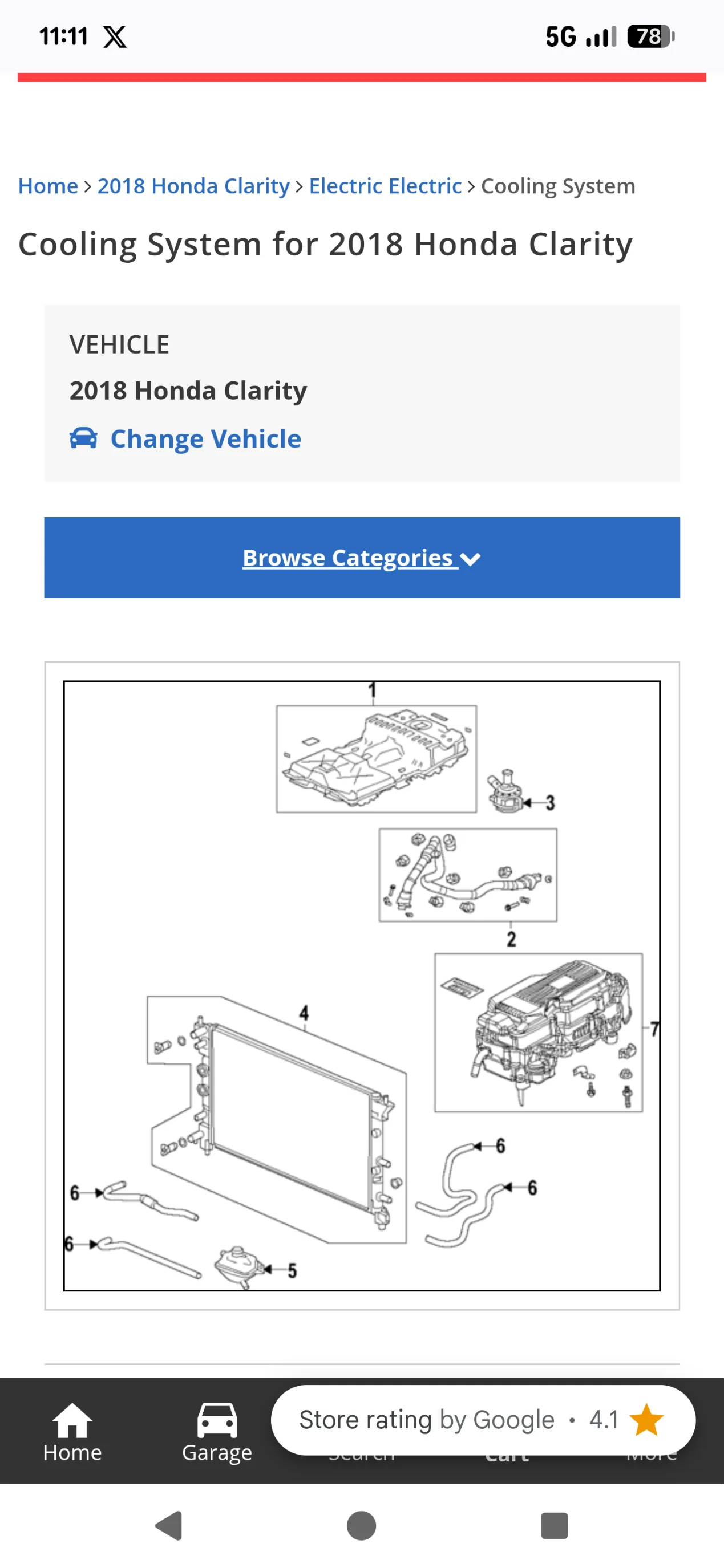

Super late for this post. I was looking at the cooling system for the battery pack and it looks like it's part of the radiator system.

Air cooled batteries use car interior air to maintain safe temperatures. Car interiors have lots of dust, pet hair, and fabric particles so air cooled batteries usually have a filter over the fan intake so the battery doesn't end up like the inside of a dryer vent. No air cooled battery, no battery air filter.
