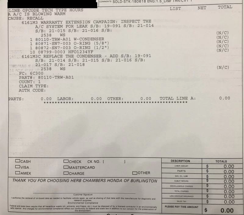

Got word yesterday that they have ordered the condenser and it should be here today and installed. They did not ask if I wanted it fixed so I am guessing that it is covered. We will see later today hopefully. I mentioned that it is lots of work to replace (you have to basically remove the front end) and they said they are very good at it because they have had lots of practice.
Car delivered as promised. No charge. Works great now. Good service from Herb Chambers Honda, Burlington, MA. Attach is bill showing all the TSBs that were applied.
It is interesting to see that the new condenser they used was 80110-TRW-A01.
We have seen some mixed messages on this part. There are parts sites that list this part as "Discontinued".
Then there was an 80110-TRW-A02 that appeared, and somebody even found what looked like an aftermarket equivalent (aftermarket parts for the Clarity are virtually non-existent).
In the past, some had to wait a very long time for a dealer to obtain a replacement condenser. Yours seemed to go very smoothly.
Also, it is encouraging to see that Honda did not try to charge you for Freon, as was reported by another forum member.
