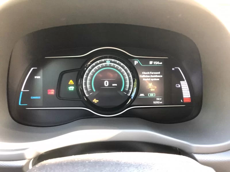

As I was driving this morning, I got the Error “Check Forward Collision Avoidance Assist“. There is no debris on the windshield or the front bumper. Any idea what’s causing this? The error won’t reset, even after restarting the car.

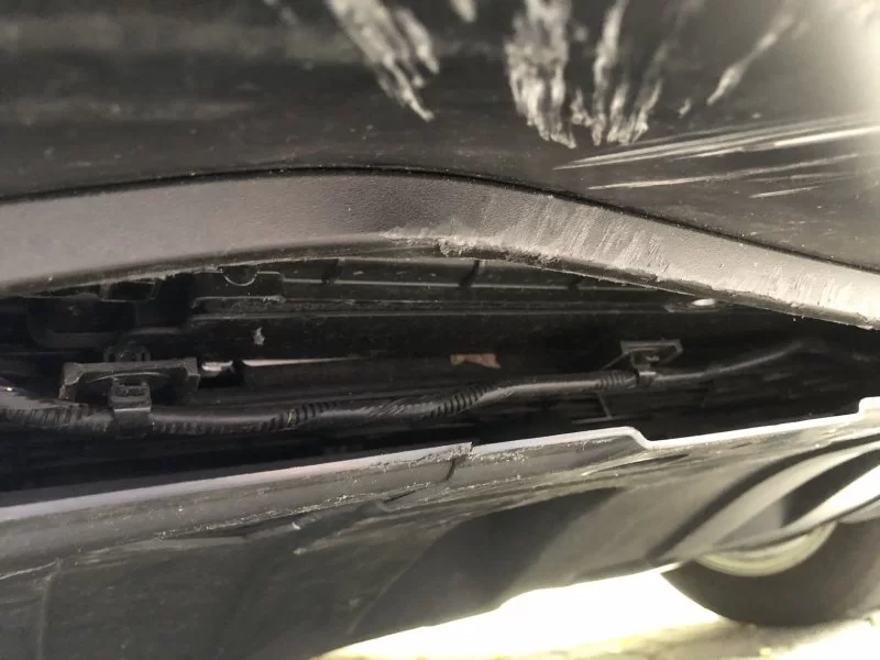

Apparently it involved a lot of damage, not just the underbody shield (which, online, only costs about 80 USD). If you ask me, this is a bad design if a scrape over a paring block causes this level of damage. I was advised by the dealer to notify my insurance company, so it'll cost me a 500 USD deductible.
This is the only picture I snapped before bringing it in. You can see how it got ripped open.
A lot more damage than I thought, too bad there was no deer hair in there and get it under comprehensive.
