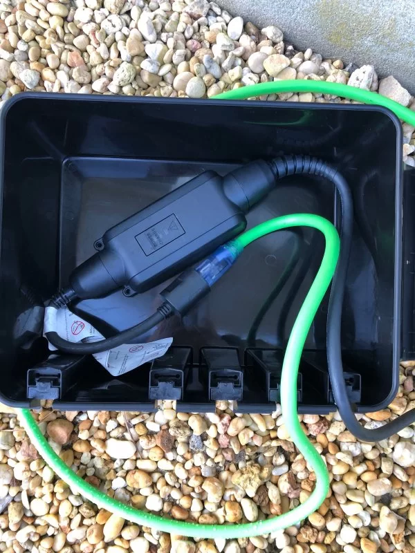

I went with a 10 gauge extension cord and it has worked well. However, I also wanted a way to charge in the rain so I ended up buying this:
SOCKiTBOX Model 330 BK Weatherproof Electrical Box, Large - Black
https://www.amazon.com/dp/B018HHMBW2/ref=cm_sw_r_cp_tai_2SuFBbQ60RYRV
I received the Sockitbox yesterday and set it up. Luckily enough, it rained last night. As advertised, the inside of the box was completely dry. See attached image for how the charger and extension cord fit.
Just wanted to pass this along in case anyone else was looking to do the same.

I don't use an extension cord, but I do use a similar weatherproof box to protect the charger from rain. I also protect the plug and the electrical outlet. No problems so far after 7 months.
I still have to buy 1 for the rain season (let's hope it will rain in CA this year)
There seems to have lots of space for the large... Think a medium will fit everything in too?
I don’t think the medium would fit the charger body. The large works. I had to fold the cables to get it to fit just right and wouldn’t go smaller.

Someone else can reply but I don’t think there’s an issue with the charger itself being in the rain as long as the outlet is protected. If I didn’t need to make the cable longer via an extension cable to reach the outlet, I wouldn’t have purchased the water proof box.
I remember reading somewhere that there is a standard for the EVSE to withstand rain/snow.... There are probably seals all around if you open it up but since there isn't a IP rating or no 1 wants to test if it works when it is submerged in water, it is probably MUCH MUCH saver to put it in a waterproof box than leave it out.... It's 22 bucks on Amazon.... Do you really want to risk a higher cost to replace the charger or even a higher cost if it damage the circuit or your car?
I bought a different charging cable (slightly longer than the Honda one). Since it was IP55 rated, I just left it in the rain (in the few days it actually rained in California this winter). IP55 is supposed to be "Protected from low pressure water jets from any direction, limited ingress protection." It failed after a few days of rain. The Clarity dashboard showed a charging system failure. So, it's possible for the charging unit to fail due to rain. That's why I got the weatherproof box, and I haven't had any problems since then even though it did rain a few times.

So technically you don’t need a waterproof enclosure for it for just rain ans snow, but considering how expensive it is to replace, the $22 box is cheap insurance.

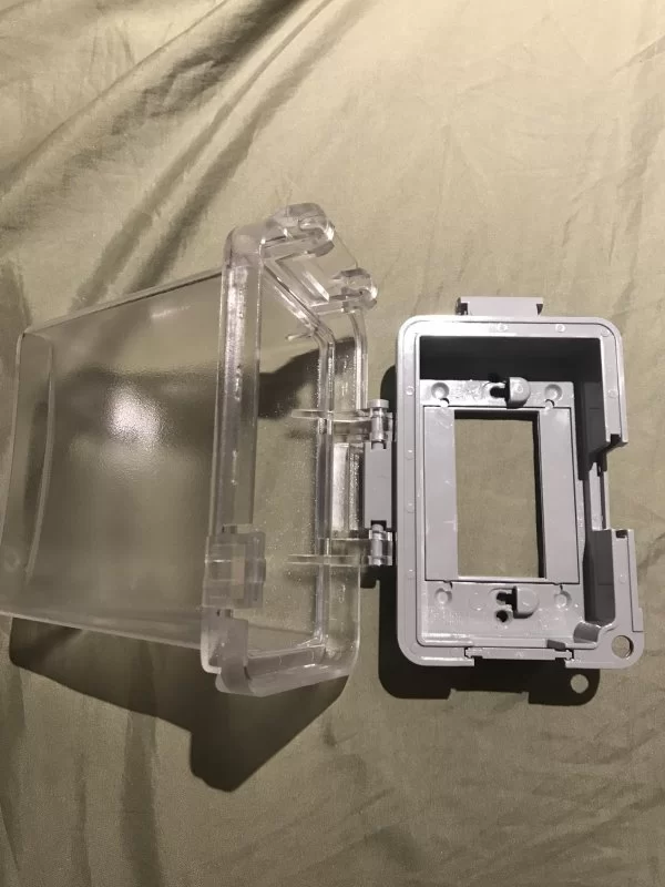

If you plug in to an outside receptacle, make sure it has a NEMA rated cover to protect that connection from rain and snow too. Here’s what I use
