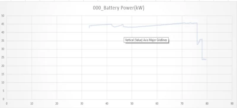

Thermal management was running during the entire session today.. The first charger shut off again after a while but thermal management was on.. Tried the charger beside the one that gave me problems and the 2nd one worked perfect for the rest of the session.. Dash and charger showed about 2.5kw higher than Torque Pro, so I assume that the Thermal management pulled 2.5kw. Intake air temperature went as cool as 64 degrees.. Outside temperature was 92F (33 C)
I loaded the data into Excel and made a chart.. It's not a smooth chart due to Thermal management kicking on shortly after starting the session..
Actual power was 2.5kw more. Peak was close to 49kw while the chart shows 46kw
Here is the interesting part of the charging session.. The drop from 45 kw to around 35kw and then to 24kw..
