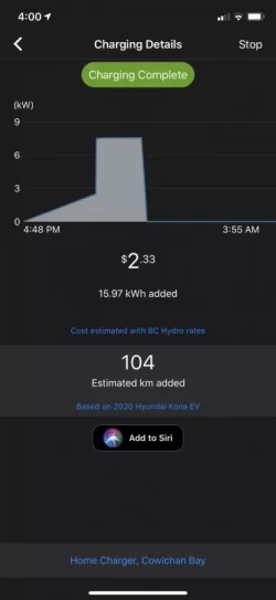

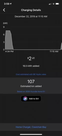

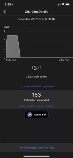

So I set a schedule to prioritize charging between 8pm and 8 am with a departure time of 7 am. My battery charge pattern is significantly different than when I just plug in without schedule. See below graphs for the last 3 days.
I don’t understand why it’s not charging based on departure time. Instead it gradually ramps and at 8pm starts pulling full charge rate.
