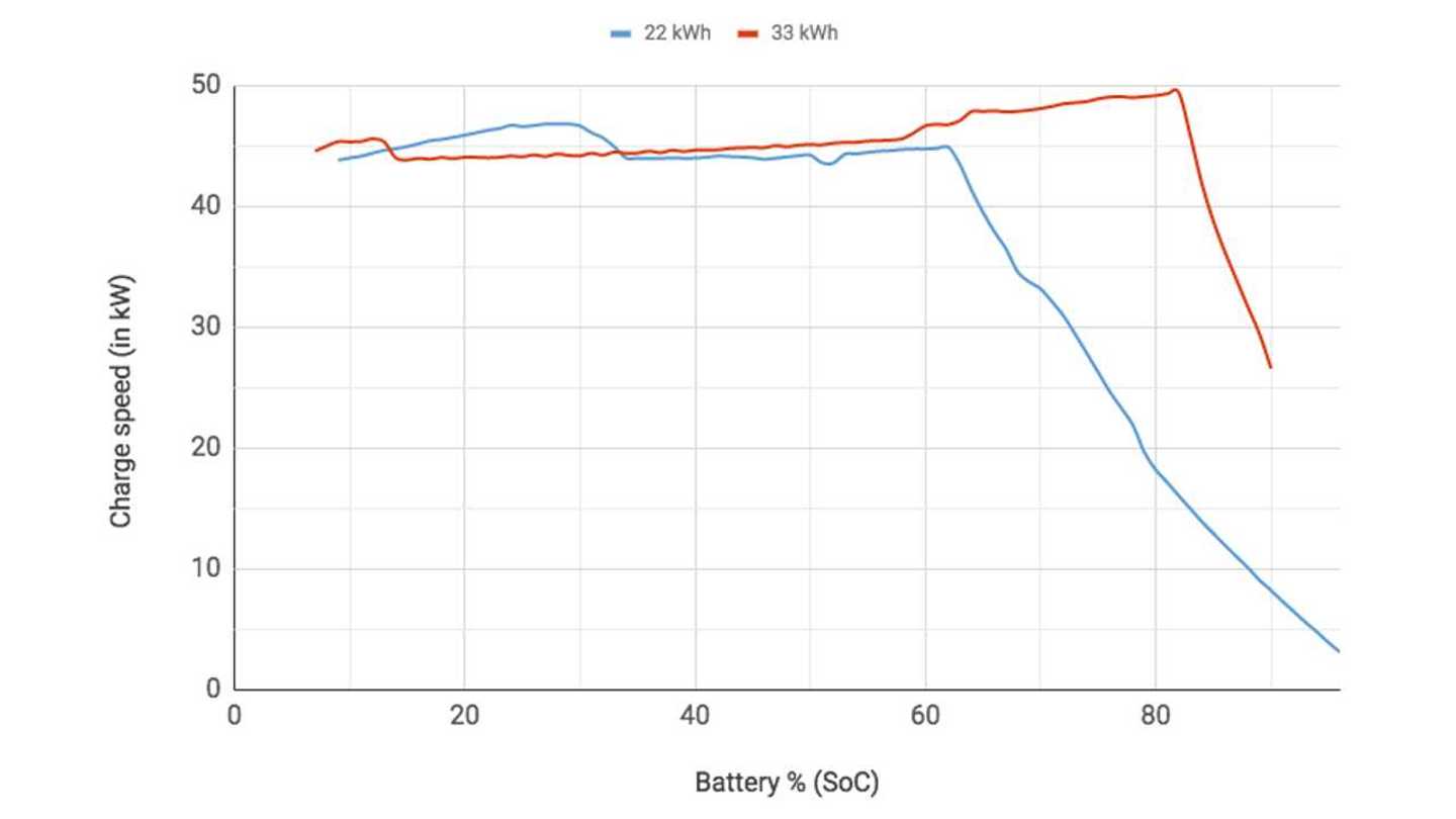

There are two design approaches to charging: constant rate, and peak rate. This InsideEV article covers many constant rate chargers: https://insideevs.com/news/338777/lets-look-at-fast-charging-curves-for-popular-electric-cars/
I've shown the BMW i3 charge curve which is limited to a maximum of 50 kW and gradually ramps up. The current is held current but the power increases as the battery voltage increases.

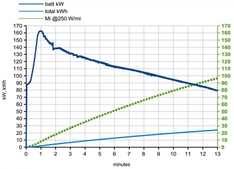

In contrast, this is an earlier charge profile for our Std Rng Plus Model 3:
Our Tesla has a peak charge that occurs in the beginning and gradually tapers off. The green dashed line and right side axis, miles, shows how fast it added range. My Std Rng Plus Model 3 is the smallest battery Tesla, ~50-55 kWh. The larger battery Model 3, ~75 kWh, can reach 250 kW peak charge rate but they also need a few more kWh/mi.
You'll notice my X-axis is in minutes while others prefer % SOC. They are welcome to their choice. My use of charging time is based upon a need to know how much time I will be spending at a charger for block-to-block speed planning.
