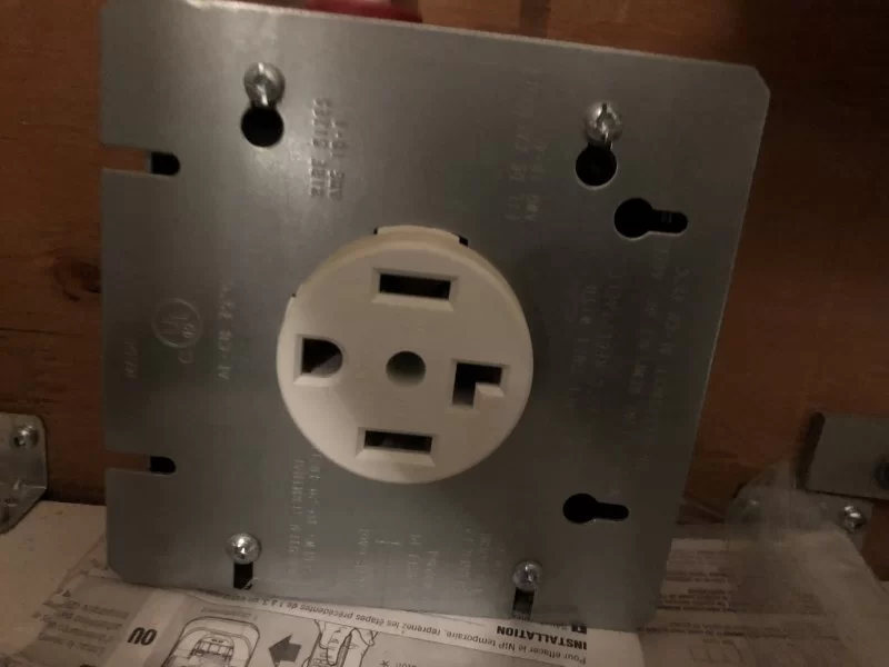

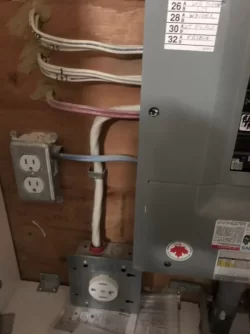

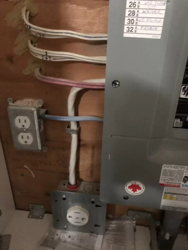

It says 30 amp as you described for power tools. I assume it is there for power tools, not EVSE. I guess I gotta get one installed. I’m in canada btw, not sure if it makes a difference. Thanks for the feedback!
If you don't want to install new Nema 14-50 outlet, you can use that existing 14-30 outlet with a 16A EVSE charger as below, but it will take longer to charge the battery to full (may be 4 to 5 hours)
If a breaker is 30 amp, you derate it by 20% for continuous use. So 30 x 80% = 24. Thus any EVSE that has a maximum draw of 24 Amps will be fine.

I would suggest that since it appears you have a NEMA 14-30 receptacle and 30 Amp breaker already that you do not get a 16 Amp EVSE because it will not take full advantage of your available power.
Instead get a 24 Amp EVSE that will charge at the higher 5.8 kWH rate and will cut your charging time down to around 3 hr 45 min. Instead of ~5 hours with the 16 Amp EVSE.
Here is an example of a ClipperCreek LCS-30p that has the plug you need so you can install it yourself. The 30 in the name means it’s for a 30 Amp circuit and it draws 24 Amp max. Perfect for you and no installation costs. Just attach to wall stud and plug

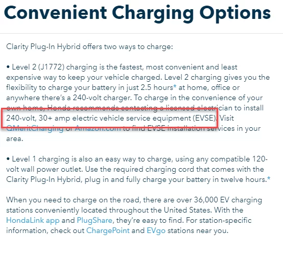

A clarity comes with a level 1 charging cable, and you'll need a 120VAC, 15A outlet to plug that in. Honda recommends a 240V - 32A for a level 2 EVSE. For that level 2 charging circuit, it needs to be 50A to support the 32A recommendation from Honda. You may want to check your electric panel to see if the circuit breaker is marked 40A or 50A. I'm not a electrician, but I believe the 50A circuit can only safely provides 40A and that fits for your Honda Clarity. As far as the plug is concerned, you need to buy an EVSE that has a plug that fits to receptacle installed in your garage, typically NEMA 14-50 or NEMA 6-50.

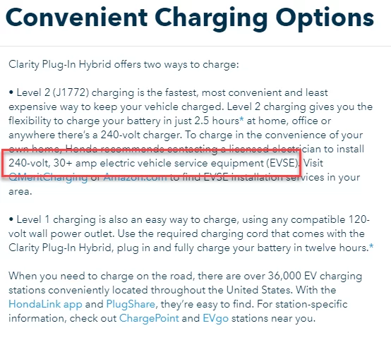

Here is Honda official statement on charging

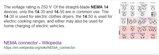

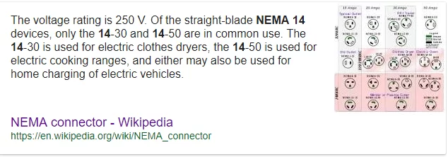

Again, I'm not an electrician so what I wrote may not be the absolute truth, but solely my opinion. When my electrician explained the options for me, he stated that there are a NEMA 14-30 and a NEMA 14-50, commonly used for household. For the NEMA 14-30, the wires should be 8 gauge and the circuit breaker should be 40A. For the NEMA 14-50, the wires should be copper 6 gauge, and the circuit breaker should be 50A. He also told me that it doesn't comply using a NEMA 14-50 on a circuit breaker rated at 40A.
The best practice is to check with your local codes or a licensed electrician for your installations & usage.
https://en.wikipedia.org/wiki/NEMA_connector
OP has a 14-30 recepacle posted on his pix. So that’s a 30 Amp breaker and 24 Amp max continuous draw if he doesn’t want to incur any installation costs.
